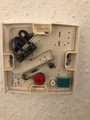

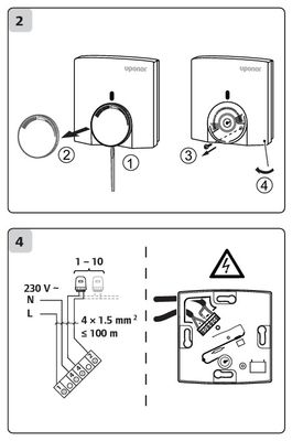

The existing uponor product has the following wiring.
N = Neutral (blue)
L = Leiter (Brown)
Black on a heating icon

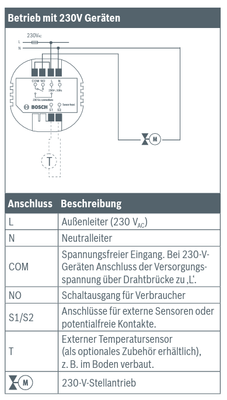

How do I connect these to the Bosch device?
The wires 'L' and 'N' is clear. where does the black one go? To 'NO' on the bosch device?

Yes, just like in the schematic. Black to NO. And COM needs to be bridged to L.
