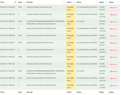

Here is a snapshot of my pi.hole DNS Server, showing only some of the latest requests of the gateway. Especially the requests to aws look strange. Are these reasonable / okish?

The queries in your screenshot are all normal, just not that frequently. This might indeed be caused by the SHC not being able to connect to these servers. Remote access not working further supports this suspicion. Does your SHC have unrestricted Internet access?
