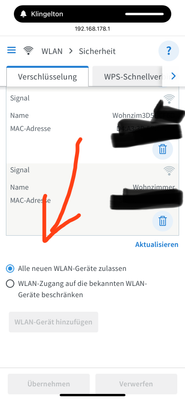

@Karsten1 in der Fritz!Box auf WLAN, Sicherheit und dort ganz unten: Alle zulassen.
Karsten1
Danke für die Info, das war schon so eingestellt.

It seems the Fritz Repeater 6000 is only allowing one camera to connect, possibly due to router settings like DHCP or MAC filtering. Ensuring "Allow all new Wi-Fi devices" is enabled is a good first step. If the issue persists, contacting support might be the best option.
