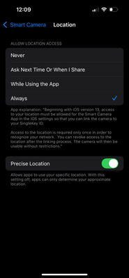

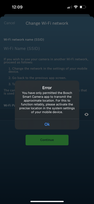

I have tried changing the wifi on my camera but I keep seeing this message
but as you can see I have this enabled
How do I fix this?

Currently the camera is trying to connect to our main router which is a distance from the camera. I have an access point near the camera but it wouldn’t connect. I have created a second 2.4GHz network on that access point and I wanted to connect the camera to that. When I tried it showed me the issue that I originally reported

My idea was to create a second SSID on the closest access point so it will appear as a different network to the camera entirely and it should then just work but that is when I see the issue reported in my original post. Is that issue presenting because it doesn’t support this?
