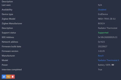

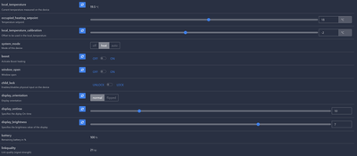

This is not completely true. Except for firmware updates the support in zigbee2mqtt* is basically there. So with a zigbee stick like the sonoff usb dongle you can connect the thermostat to a raspi - if said raspi is running zigbee2mqtt.
*should be there in the december version
