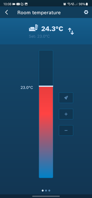

However, I have discovered that the thermostat never seems to stay at 23°. It is always either more than 1° above or 1° below the target temperature.
For example, when I wake up at 8:00, the room thermostat shows that the actual temperature is 24° or even higher. It seems that the radiator thermostats have opened their valves to 100% for too long, and this resulted in the temperature increasing beyond the target 23°.
I've attached a screenshot to show this. You can see from my screenshot that the target temperature is 23° but the actual temperature is 24.3° which is too hot.

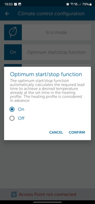

One other note: before I purchased the Bosch Smart Home devices, I tried the smart thermostats from Homematic IP. In the end, I sent them back to Amazon for a refund, because I didn't like the way they worked. However, one feature that I liked about the Homematic IP thermostats, is that they did maintain a stable and constant temperature throughout the day. And their app also has a feature called "Optimum start/stop function", which allows the thermostat to calculate the required lead time in advance, to slowly close the valve before passing the target temperature. I've attached a screenshot here of this feature. I think it would be helpful if Bosch can introduce something similar, to help prevent the thermostat from allowing the temperature to go above and below the target temperature throughout the day.
