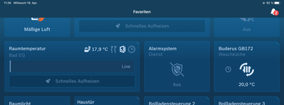

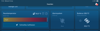

If the KM100 is compatible with the MyBuderus App, you can add your GB212 to the Bosch Smarthome App.
It will then send the requested temperature value to the heating, please see example with speed heat up activated:
What I’m not really sure is, if these setting will overrule the RC310 value. But I think it should.
