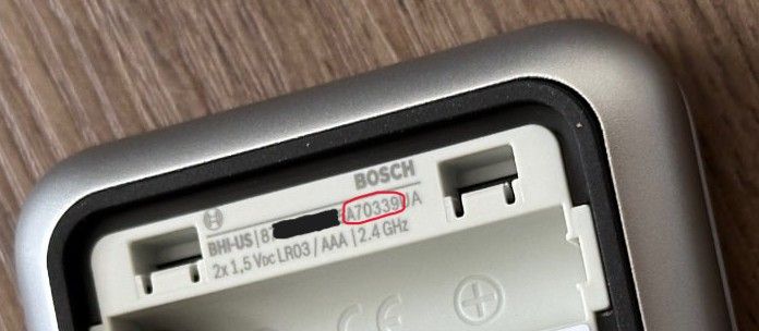

@kukrapok Please check the 3 number FD (production Date). If it’s below 437 it’s possibly a hardware error. Then you will need the original bill for the switch.
Interesting lead.. But where can I find this 3-digit FD? I can't find any 3-digit number anywhere among all the codes printed at the device back,.
Look for "A70" followed by a three digit number. Here it's 339:
A70-380 here!
Then contact support to get it replaced. It's defective.
