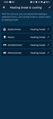

In general, the system provides an internal function for that, in the german app version it is called "Heizpause". Unfortunately, I do not not know the exact wording in the englisch version. With that the radiator thermostats are going to the lowest set point and showing "Off" in the display. Just freeze protection and weekly recalibration / descaling of the valve are active. In all other functions like automations and so on, the thermostats will be ignored.
Just set them to heating break in the climate manager:
