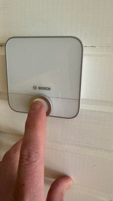

After each update, the Smart Home Controller II is automatically restarted, and the Relays and the Universal Switch II is automatically reconnected with the controller. However, the Room Thermostat II’s loose their connection and show up as “The device does not provide any status feedback” in the app.
After the first two updates, I needed to go and press the button on the Room Thermostat II, twice and then it reconnected to the Smart Home Controller II. Now the third update occurred while I am not in the house, and I don't have the ability to manually reconnect the thermostats by going and press a button on them.

In order to get the RT II's connected again, I need to go and press the button on the RT II's - but that is only possible when you are there.. 😉
