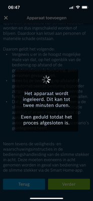

😭 Nothing is workig anymore after update.Yesterday, i updated the bosch smart home controller II to the latest firmware version, after the installation all the matter-accessoires didn't work anymore in Apple Homekit. So I updated the bosch smart home app and also my iphone 13 mini to iOS18. I removed the bosch hub in matteraccessoires of iphone settings and in homekit. Afterwards I did a hard and soft reset of the bosch home controller II+ reinstalled the bosch smart home app. Then I reinstalled the bosch home controller II without any issues, but afterwards i wanted to add my devices again and i can't succeed that. I can scan the Q-code and then it keeps turning to add the device. So at the moment I can't control any device, not in Bosch smart home app, not in Apple homekit, because I can't add any device in the controller. => no heating possible in my house. Any problems with the latest firmware? Can I do a downgrade of the firmware?

Thanks for your fast answer. Despite, i already tried that also, I resetted all the devices manually. Same problem...
Hi @NicolaasDenijs , please contact our support:
Regards
Hallo, I already made contact with Bosch, they proposed the same after reinstalling the controller. Now I resetted all the devices, plug them all out, batteries out of thermostates and smoke detectors. After 2 hours power off all devices, I was enable to reinstall them all, so I can see all the devices again in Bosch Smart home app, but still not possible tot contact Matter, so controlling temperatures in Homekit is not possible anymore at the moment.
