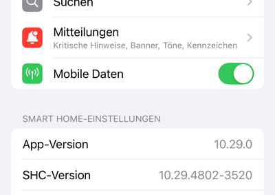

I'm asking because since App version 10.24.xxx it is now possible to access older controller versions. But because you're very likely on 10.24.xxx I suppose the the problem is located somewhere else. You can see the App version btw of "Smart Home" on iOS and Android in the properties of the App:
