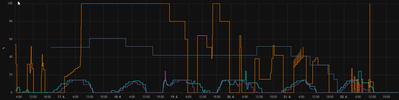

I forgot write - you can see on graph, Radiator thermostat II have on Saturday test period for valvetapes (1st graph). But for Radiator thermostat are test period for valvetape are missing (2nd graph).
Don't know about the graph, but I can clearly hear my thermostats (1st gen) doing their routine every Saturday at 11. They're not exactly silent. 😉
Yours don't do anything? Or are you only relying on the graph?
misa15
About investigation - not work of test period for radiator thermostats 1 - found for room with two installed radiator thermostat 1...
